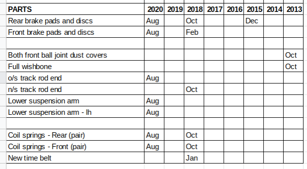

I am reviewing the service history since 2011 to get a full picture. Will publish below...

Just wanted to add the table below. Hopefully useful for anybody wondering about their own reliability. Clearly I experienced some reliability issues between 2018/20. I trust my garage on the replacements cos most recently it was looked at by 2 outlets.
